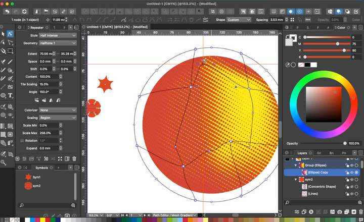

        Further to the above - thought I'd have a quick go with the ref image in the post and it all seems straight froward, although VS tracing is not as good as ImageVectorizer (which I would normally use) Really great that we can now access the symbol which is repeated in Raster work without having to create a symbol from scratch👍
        :0_1660213248991_Screen Grab 2022-08-11 at 11.16.02 am.png
        Heres the VS file:0_1660213362622_Halftone beard.vstyler

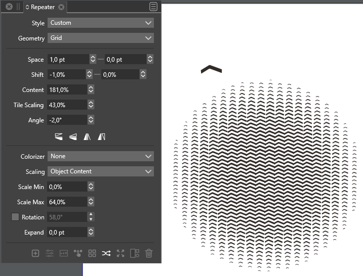

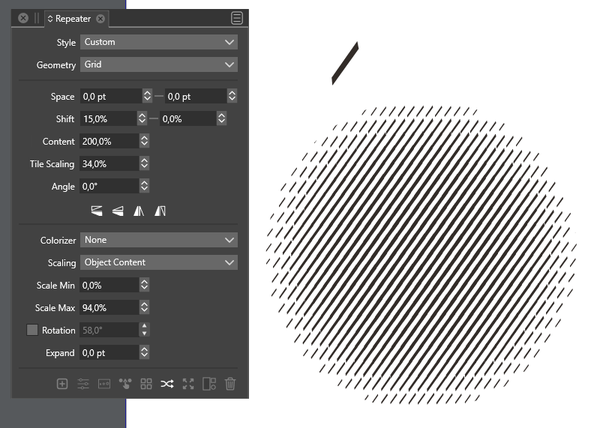

                  I just like to tell that i found a way to get a Halftone Line like Result in VS.
                  Edited:
                  Part 4 is now online an will be found here
                  ...a kind of halftone Lines, Part 4
                  Here a Example
