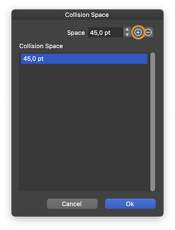

EDIT: Oops, I didn't see the reply of the admin, so I'll just leave the screenshot here:
It works here: https://recordit.co/KZaEEvdKIj
OK
There is a (+) button that may need to be pressed to add the spacing. Multiple spaces (including the default 0) are allowed.
Yes, I tried with a few entires in the list - didn't work. I removed all except the single 5mm one - still didn't work. The + key adds an entered value to the value list.
