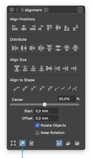

@Igull Is 'Align to key object' enabled here?
@Igull Alignment of nodes is done relative to the bounding box of the selected nodes.
Yes.
OK, perhaps I'm not understanding that, up is up according to the screen surely - whether the object has been rotated or not (the bounding box reference)??
Or am I missing something ?Neil
@VectorStyler said in Node Alignment Broken:
Ahhh, the penny drops
Now I get it, the reference to the key in the alignment panel - carefully hidden to trap the unwary LOL
I'm sure those three options must be extremely useful to someone, just not to me LOL.I think that explains my issue, the bounding box is selected from reset, I must have clicked the key at some point down the testing path and my settings would have been saved too - mea culpa
