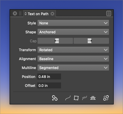

    Hi
    If I understood you correctly.
    Is the option "Check to reverse the direction of the Path" not helpful for that ?
    In the "Text on Path" panel.
    (the fourth icon from the left at the Panel bottom)
    See Video here
    @Boldline Added this to the backlog. I will try to figure out a way.

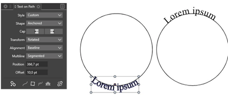

    Tried a bit in VS. It seems like you can't avoid some problems by grouping Circle and Text together.
    Place your first text at a circle then select both and group it.
    Then copy this group and switch the text down on the copy.
    Until then you could align both.
    Must correct myself, VS has proven me wrong.
    When I simply copy a group like this, the text is flipped back.
    Seems to be a bug.

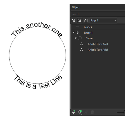

    Dealt with text on a circle many times in my last job and know the issues.
    Btw. in Coreldraw the upper and and the bottom Text could be on the same Path and independently edit.
    is just one Path
  • @VectorStyler seems a Bug here
    Text on Path flips even if i simply copy it.
    See Video here
    @Subpath Please send me that file, I will try to replicate it.
  • @VectorStyler
    File has been sent

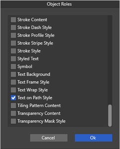

    It's late, but I'd like to point out a find i made in Object Roles.
    While I was looking for something different.
    Found it in Object > Object Role > More Roles.
    There is a Role called "Text on Path Style".
    The Manual says:
    "The object's text-on-path settings act like a text-on-path style".
    It's unclear to me how that works.
    But looks like some kind of preset for Text on Path?
