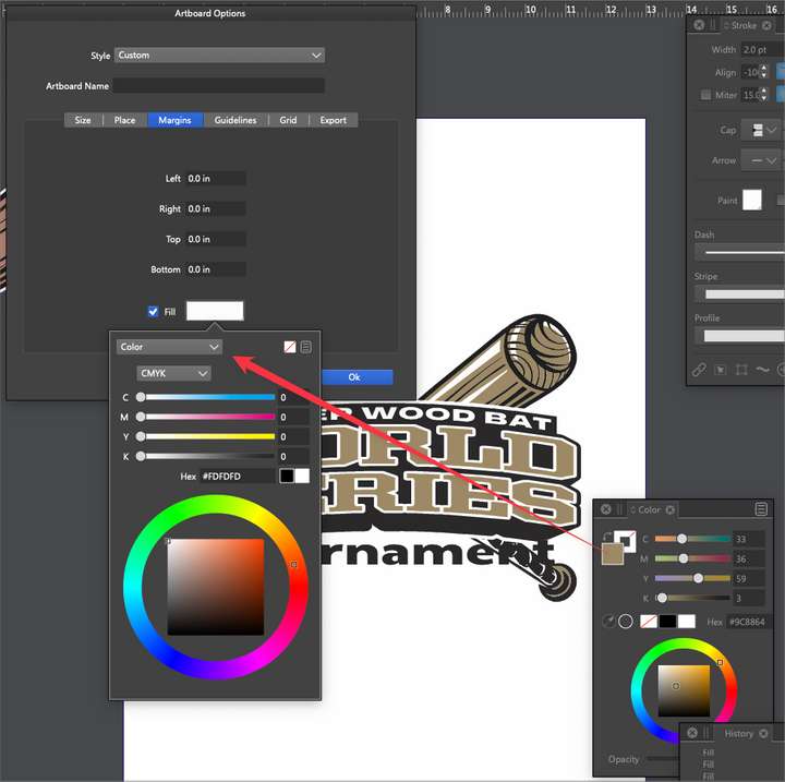

Could the color panel color select option in artboard panel be tied to current color panel settings?
  • I understand the artboard panel is modular - does this keep it from being able to use the current color panel settings when you select the color panel from within the artboard panel?
    0_1652284077181_faceb98b-b77f-4285-aa22-8c7887829479-BLD 2022-05-11 at 11.46.30.png
    @Boldline This could be implemented, but the question is: what color should be the default when Fill is checked?
    Currently this is white (since it is the most likely artboard background).
  • @VectorStyler I think it's good to have white be the default - that makes the most sense. My end goal is to be able to make the artboard background any color I want. For example, the ability to sample from a linked png image. Ideally, I'd think an eyedropper in that artboard color section would be best, but I understand with the panel being self-contained, it can't go beyond itself - so the next best thing would be the ability to add colors to a palette beforehand using the eyedropper tool for example, in the main palette panel and then have those colors show up in the swatches and/or active color choices when choosing a color in the artboard panel
