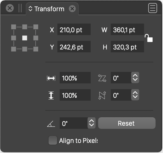

@markus For this case (resizing path shapes) you need to use the Transform panel.
The shape panel (opened with the "..." icon) uses the size lock only for the rectangle and ellipse panels. This is because the Shape panel edits the properties of a parametric shape (a.k.a live shape).
After creating a union of 2 shapes, the rectangles become a path shape.
This is the shape panel for a path object, nothing much to edit here of a path:
This is the transform panel, here it is possible to set the size (and lock it):
The Shape panel lock icon is at the wrong place, and should not even be visible when path shapes are selected.
@VectorStyler I guess Markus would like for the aspect lock button in the Transform panel to
constrain the aspect ratio not only when editing the number fields in the panel but also when
scaling the object on the canvas directly. -
@b77 Ok, this could be a new feature. Added it to the backlog.
