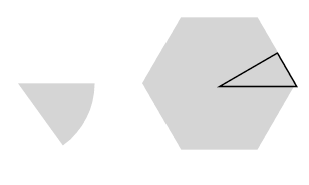

Sections for Polygon Shape
With the Circle in VS, Circle Sections are also possible.
I wanted to suggest adding this to the Polygon Shape as well.We can do this with Booleans, but why not directly?
One advantage would be that it remains editable and i think
this would be helpful for symmetries.Video here
Polygon Shape Sections

I would say any angle if this possible, just like the Circle Sections does it ?
@Subpath said in Sections for Polygon Shape:
@vectoradmin
Agreed, but with an option to snap to the sides while setting the angles, as that would likely be a common scenario?
A simple button or checkbox to split the polygon or star-based shape into it's sides or "rays" is faster, and if this has an option to have those sides also divided in halves starting from the center it's even more useful.
A way to divide a polygon into fewer or more parts than its sides can be done separately, I would say.
I am not fixated on a solution.

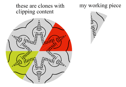

I was thinking about it while I was playing with pattern creation in VSAnd I like to use Clones for that. With Circles Sections, I do it this way.
Doing that with (cloned) Polygon Shape Sections would offer
the possibility to distribute the pattern and it would keep the
Shape editable.
