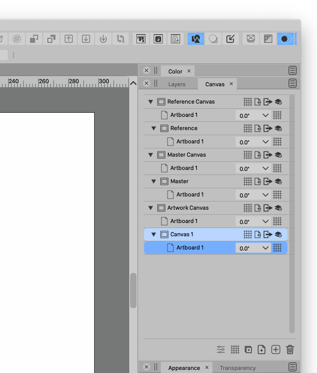

      When new document set up.
      The document structure is strange.
      Is this correct?
      From which version did this happen?
      LIc. 0 OS10.15.8
      LIc. 1 OS15.8.1
        VectorStyler @861475_VctSt
        @861475_VctSt
        Here the "Canvas" panel is active (not the Layers panel). It might be that you wanted to use the Layers panel?
        This was present from the beginning. Typically the "Canvas" panel is not used, it is a VS specific feature.
        A VS document contains multiple canvases, and each canvas has its own Layer hierarchy.
        For a single canvas see the Layers panel for its content.
        Multiple canvases can be used to setup "master page" like features (master canvas), and to have symbols or other design assets on "Reference" canvases, etc.

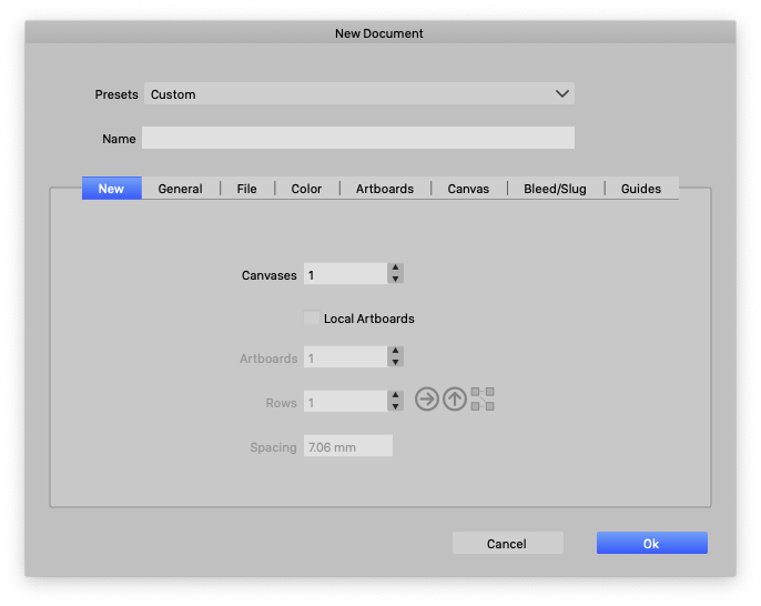

          Let me go back to the beginning because I did not explain myself well enough.
          Suppose I am trying to create a single-page artwork.
          First, when I do New Document Setup
          The value of Canvases defaults to "1".
          If the document is created as is.
