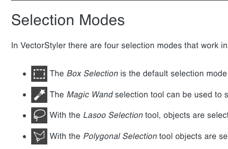

As usual, I need to take the time to throughly read the help of a new software and not make assumptions based on similar software. This above issue is covered in the help:
@ideagonal
