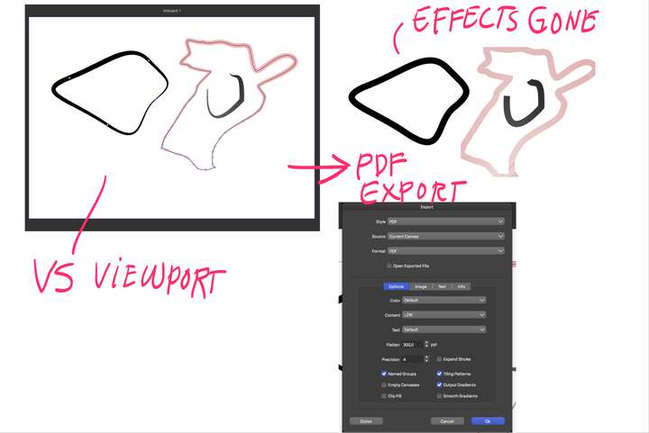

      I am testing VS as my prospective new vector drawing software and are completely noob yet with experience from Inkscape, Affinity Designer and AI.
      Just to try something I have created some curves wiyh variabel widths
      Yet I'm puzzled by the bad quality of a simple exported pdf which appear very odd according image below. Have I missed something?
      Kind regards, Raaskot

        @Raaskot Click 'Expand Stroke' in the Export window and the paths should preserve their profiles.
        @vectoradmin I think this should be enabled by default.
        RaaskotR 1 Reply Last reply Reply Quote 2

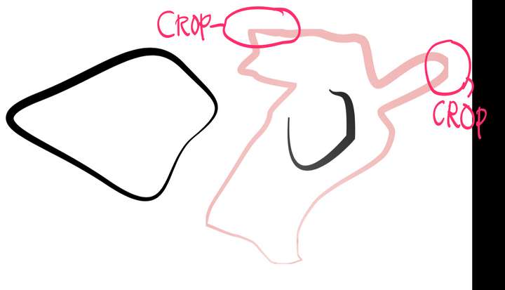

          Wonderful, much better!
          Yet the right shape appears cropped. Any idea how to prevent this?

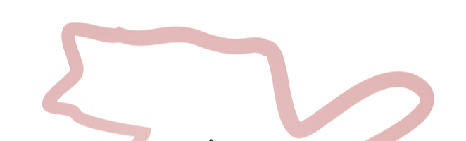

              Crop seems to match the bounding box area:

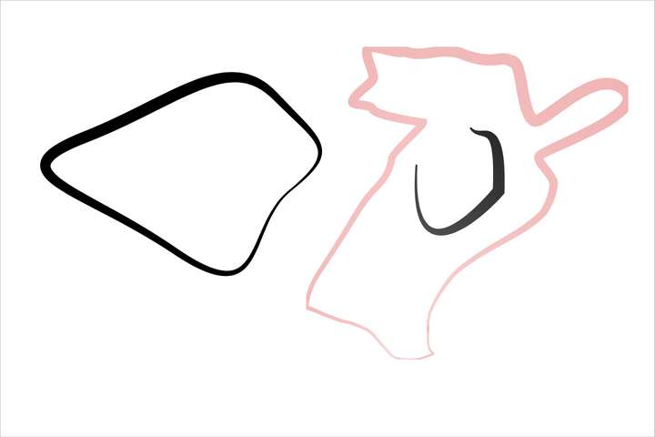

                    I went ahead and expanded the strokes (the black stroke inside the pink outline is clipped
                    I exported as a pdf and turned out as expected, not missing areas

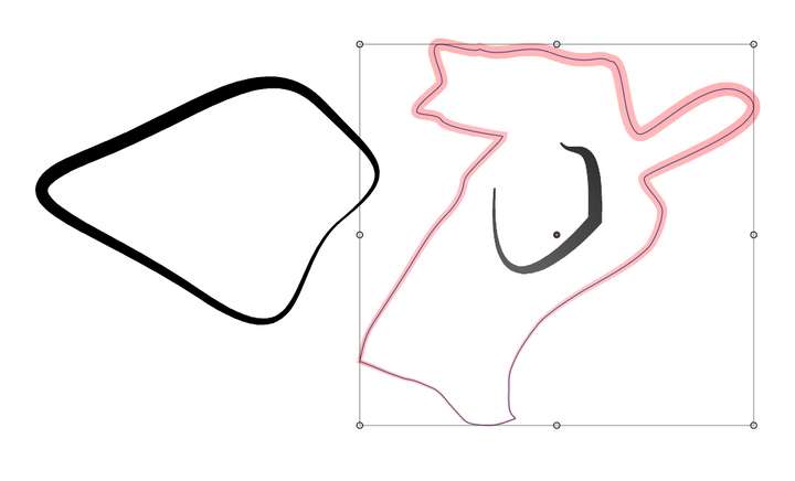

                    I was able to replicate your issue if I had an active selection of the paths and did not expand the stroke first when exporting as a pdf
                    0_1645896639916_7cd76fe4-f84b-42eb-96a0-be2b5ddc0b3c-BLD 2022-02-26 at 12.30.06.png

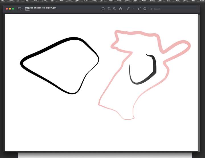

                      Very good, I see. Now it works. Made it work after applying ctrl-shift-s (expand stroke)
                      Yet strange that this issue doesn't appear for the left shapes part:
                        VectorStyler @Raaskot
                        @Raaskot Looks like the cropped shape issue is a bug. Will be fixed ASAP.
