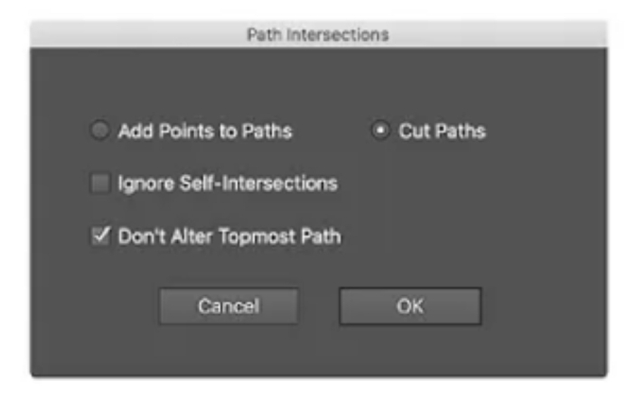

 @vectoradmin There is an option in AI called Path Intersection which is very useful. Like if we have many intersecting segment then we can cut all the segment at Intersection.
