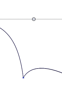

  • When I convert a smooth node into a cusp node VS keeps the curve almost identical to before the change.
    Affinity behaves like this when I turn a node into a cusp node:
    alt text
    This fits right into my needs and expectations when I am converting a smooth node to a cusp node when hand tracing, adjusting the cusp node to a sharp cusp node manually is a bit annoying in the long run (adjusting many nodes), but I do understand that this may not be popular. So my request/question is that a second toolbar click/keyboard shortcut activation triggers this behavior ie turns the cusp node into say a 45 degree angle cusp node. That shouldn't interfere with anything.
    So in short activating cusp toolbar button or shotcut on a node already cusp turns in into sharp cusp node. Like this: L Respecing the angle the node and curve had before, of course.
    PSST: This makes the corner tool much more fun to work with BTW.
    Unless ya all surprisingly want it as default behavior. 🙂

    I am not nesasseraly looking for straight lines. More often just looking for the sharp corner that you will find in many handdrawn or painted drawings/paintings but with curved lines going out from it. When I handtrace a lot I accidentially make a lot of smooth corner nodes that I change later not to interupt the flow of tracing. I assume manually processing vectorized art also requires some node adjustments.
    Turning it into a sharp node like in Affinity goes super fast and with the corner tool you can smoothen it to your liking.
    I have mentioned it before. Smooth fast workflows makes it infinitely faster to work with complex documents.

    @Ingolf said in Cusp node second click idea:
