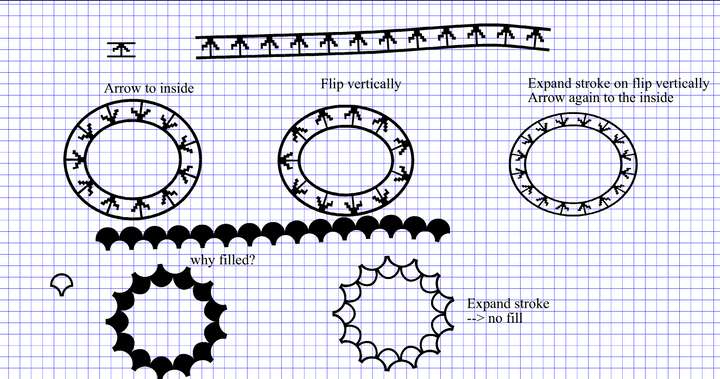

                  @vectoradmin did send you one file with two vector brush examples.
                  here a screenshot of the file.
                  As said I am new to VS, and I could be mistaken with some things.

                      VectorStyler @MajorTom
                      @MajorTom Got it! The problem here is that all these brush types set the fill mode to Winding Fill mode.
                      Workaround: edit the original shape, and reverse (Object -> Shape -> Reverse Path Direction) the path direction.
                      Then create a new pattern brush.
                      I open a bug on this one, and try to avoid setting the fill mode automatically to Winding Mode when doing brushes.

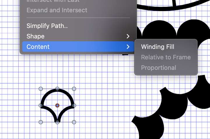

                      • M Offline
                        MajorTom @VectorStyler
                        @vectoradmin
                        Thanks I will try the Reverse Path Direction, in the mean time I did check but the Winding Fill is not active for that shapes.
                        One additional question. For the brush with the arrow.
                        Should the arrow point to the out side or to the inside on the circle.
                        I would like to have the arrow to point to the outside.
                        Thanks a lot for the quick response here.
                          @MajorTom said in New user: Issues or user error?:
                          @vectoradmin in the mean time I did check but the Winding Fill is not active for that shapes.
                          Yes! And in this case it should be active, to display the shape as it will be displayed in the Pattern Brush, where this option is automatically on.

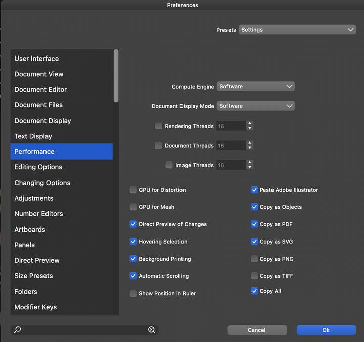

                                    1. Example 2 freeze
                                      I think I found the root cause for the Example_2 reset.
                                      I have Copy as PDF, Copy as SVG, Copy as Objects active.
                                      If I deactivate Copy as SVG and Copy as PDF, no reset. So it seem that one of the two other checkboxes is causing the freeze of the VS or the combination of that all.
                                      Hope that helps you to figure out the freeze. perhaps stupid from my side the check them all, but as long as I can do it :-).
                                    2. Example 1 freeze
                                      By the way, with the settings from the screenshot, VS still does freeze at the export of Example_1. CPU load maxed out to 1600% for VS and no further reaction. Did kill VS after 3 minutes.
                                      @MajorTom I will try to fix this issue.
                                        @MajorTom The "Document Display Mode" should be set back to Metal. This does not affect the exporting issue, and the Software mode can be very slow for editing.
