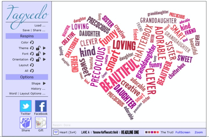

As I used it, it reminded me of the "future feature" we spoke of a year ago where shapes and/or words could be sued to fill a specific shape. There are websites that can create the shape or allow you to import a shape and then add the words to be used to fill that shape
The issue with these sites is that they don't release a vector file and whatever you make, the best you can do it use it as a template to arrange the words by size.
With the addition to VS of "split text" to allow for words to be divided up easily from a source list, and now repeaters - We're a lot closer to that possibility of making word clouds in VS in vector.
Does VS have a size randomizer option? I know there is the option inside repeaters. Where I could select a bunch of vectors or groups of vectors and automatically scale evenly by size between two extreme sizes? and/or an option to randomize the size of the selected shapes? Essentially that would be the last step to creating something like this.
