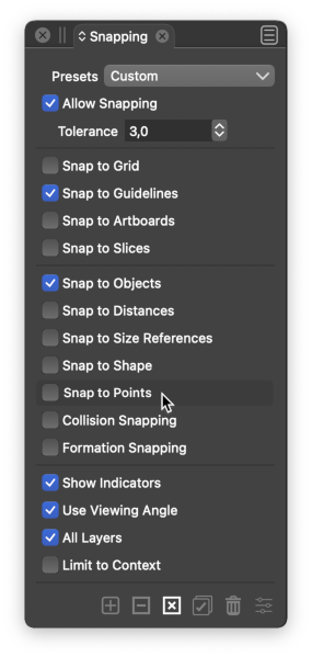

when you hover the button to activate snapping and you click it, it looks greyed out until you stop hovering it. Confusing when having a quick glance, it should turn blue.

I agree, good observation about the snap-to checkboxes not turning blue on hover.
Another alternative I would prefer is a darker area under the cursor:
