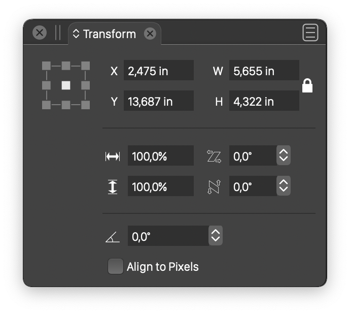

    @Torakikiii Forgot to mention one detail:
    Proportional scaling is enabled by clicking on the lock icon next to the W/H boxes.
