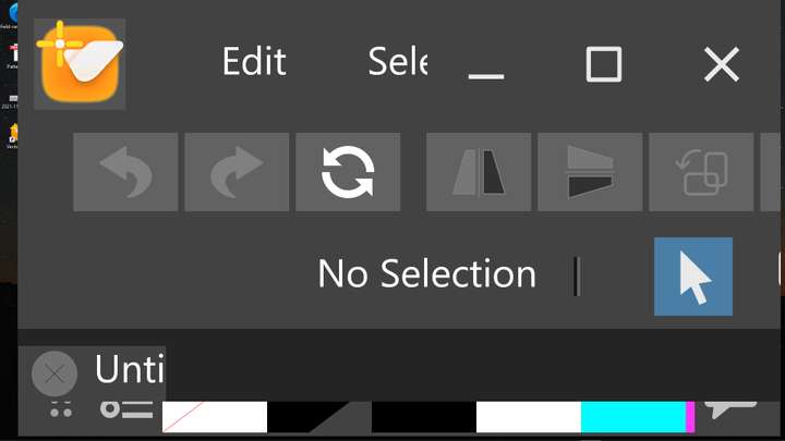

  • If I select an object and press one of the keyboard arrows to move it slightly, it moves quite far from the artboard. I was trying to fix this in the preferences and I made a mistake, I ended up with tiny, unreadable menus. I tried to correct my mistake, a bit by guesswork and now I find myself with the opposite, everything is huge and I can't navigate at all in what I see. I uninstalled, restarted my machine, reinstalled VectorStyler but nothing has changed (see my screenshot). Installing in another folder didn't help either.
    I hope you can give me a solution, thanks in advance.0_1636904339858_2021-11-14_161519.jpg

    @Longwy To reset all settings to default start the app by:
    on Windows: hold Control+Alt+Shift then start app
    on Mac: hold Command+Option+Shift then start app
  • Thanks for the quick answer, unfortunately the result is always the same.
    @Longwy On Windows go to the C:\Users\<user name>\NumericPath\ folder and delete the VectorStyler1.0 folder (contains settings, workspace customization of VectorStyler).
  • @vectoradmin Thank you very much, the problem is solved, and bravo for your reactivity, very much appreciated!
