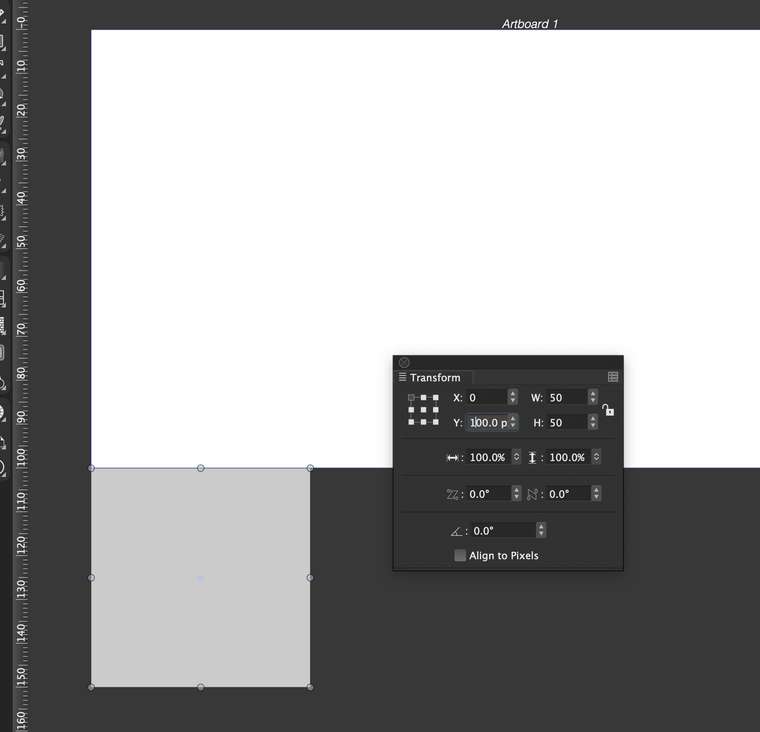

    In beta 159, setting the transform origin for an element to top left - then positioning the element to 0, 0 in transform results in Y coordinate using the height of the artboard. This incorrectly positions the element off the artboard.
    Did replicate this, it is a bug. Fix will be in the next release.
    build 160 fixes this, and several other issues regarding the ruler and coordinate system direction.
