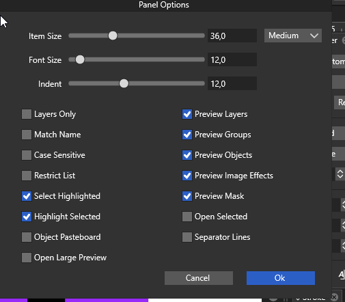

Can you send a screenshot of the options selected Layers panel menu -> Panel Options?

@encart Turn off Select Highlighted and Highlight Selected.
It looks like there is a bug when these are active.
@vectoradmin Thank you! Now it's fine.
Edit:Deselecting these two fixed the problem with renaming as well.
