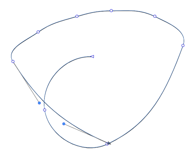

      @Daniel Sorry i miss a little all the conversation, because my english: Is possible to do this examples with VS now, or it is a suggestion for future development?
      I tried with sample 1, i got this:
      I used click and alt+click.
      Ryzen 9 3900X on Asus prime x570-p
      Memory 48gb ddr4
      Nvidia gtx 970 on an Asus strix, 4gb gddr5

        VectorStyler @marce
        @marce Should be possible to get those cases from the image.
        I tested them, I will retest the final build and see if there might be some bugs.
