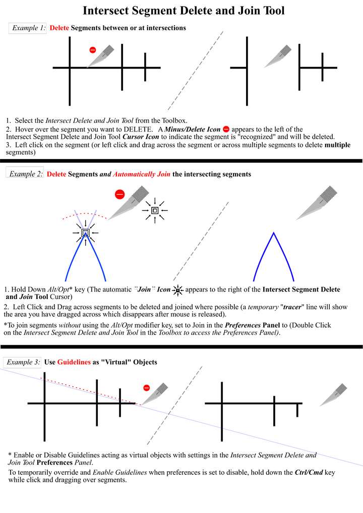

    I would like to see VectorStyler add what I am calling an “Intersect Segment Delete and Join Tool”.
    What the Intersect Segment Delete and Join Tool does:
    Lets you Delete portions of objects that are between or at the intersections of Objects (or objects and Guidelines**), with the Option to automatically Join the trimmed paths after segment deletions.
    How it works:
    With the Intersect Segment Delete and Join Tool Icon selected from the Toolbox:
    No objects have to be selected (unless specified in Preferences). Just use the tool.
    1. To Delete a Line Segment between or at Intersections:
    • Hover over a line segment. A Minus/Delete Icon appears to the left of the Intersect Segment Delete and Join Tool Cursor Icon to indicate the segment is recognized and targeted for deletion.
    • Click directly on a line segment to delete it. This deletes the segment section that falls between or at the Intersection of the two objects. (or Object and *Guidelines),
    • For a Segment that does not intersect/fall “between" two objects, the segment is deleted and trimmed off at the intersecting point.
    1. To Delete Multiple Line Segments at one time.
    • Click and Drag* through all of the targeted segments. Release the Mouse to delete.
    *As you click and drag you see a temporary live “tracer” dotted line, in a preset color (changeable in the Preferences Panel), of where you have clicked and dragged to show what is being selected). Release the mouse to delete.
    If you make a mistake in your click and drag selection and missed or selected something unintended, Hit the Esc Key on your Keyboard BEFORE Releasing the Mouse so you can start over and try again).
    To select with a Box/Rectangle Marquee, hold down the Shift Key and Click and Drag over the segments and release the mouse to delete intersections.
    1. Optional Automatic Join Segments with Modifier Key
      Hold down Alt/Opt key (the Intersect Segment Delete and Join Tool Cursor Icon changes by adding a “Join” Icon to the right of it.
      Click and Drag* through all of the targeted segments. Release the Mouse to delete the segments and automatically join them where they intersect.
    • To Join segments without using the ALT/Opt key, set to “Automatically Join” in Intersect Segment Delete and Join Tool Preferences Panel).
    **Bonus:
    The Intersect Segment Delete and Join Tool recognizes GUIDELINES as a “virtual” Objects so it can also delete segments between the intersections of an Object and a Guideline.
    Suggested Preference Panel Options (To access: Double Click on Intersect Segment Delete and Join Tool Icon in the Toolbar):
    • Temporary Tracer Line Color (click on Color Swatch Icon to select and set the desired color)
    • Enable or Disable Guidelines as virtual objects (check box)
    • Only Allow Segment Delete and Join if Paths are Selected (check box)
    • Enable or Disable Automatic Join after segment deletion (check box)
      • Paths with Same Style (check box)
      • Paths on Same Layer (check box)
    Here is three samples of the Intersect Segment Delete and Join Tool and how it could work:
    0_1624649200739_VectorStyler_New-Feature-Request_Intersect_Delete-and-Join-Tool_FINAL-Posted_Screen-Shot.png
    This Intersect Segment Delete and Join Tool is a kind of a hybrid “best of” combination of the Astute Graphics "AG Trim and Join Tool" and CorelDRAW "Virtual Segment Delete Tool".
