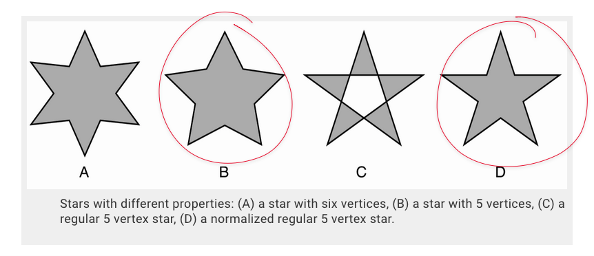

Would it make sense to add a keystroke modifier for the star shapes? So that if held down while creating the star, it would create the regular star or the star with curved lines? like options B and D in the pic from the VS guidebook? Could this option be added to all star options? Even A and C? Illustrator does this. I know it can be achieved in the star panel settings I assume?Is there a way to make a 5 vertex star sit flat when created? So the two bottom vertices are level?
@Boldline The revert icon should restore to the default star shape. Also: the Regular (and when enabled the Normalized) checkbox can be used to get to case (B) and (C).
I will add key modifiers to the star drawing to control these options while drawing, but it might be more limited than the panel settings.
The Shape panel can be used to control all star (or other) shape properties.

I understand the modifiers may be redundant and limited compared to the the amazing control options in the panel. From my view, it could be an easy quick way to create a simple star or bloated one lol
