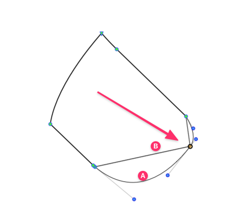

It's effectively useless as it does not do anything when I click or drag. I will try it on the intel computer and see what happensusing VS build 36 on my intel mac I got this odd result:
"A" shows where the line was originally and "B shows where the anchor point tool modified it to be - but the initial line remains for a while
@Boldline I tried with an ellipse and its contour stays until you change the tool: https://recordit.co/pfk2twyW2H
@b77 yeah seems like the intel version has some bugs. I'll try on my windows laptop shortly and a different M1 computer and see if I get the same results I initially posted where it does nothing.
