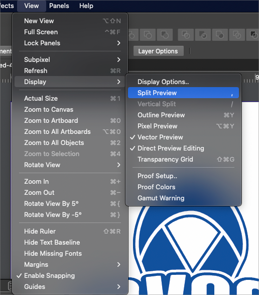

  • @Victor-Vector did you try out split view? It will tile all open tabs, including any new views created
    0_1650509771915_3dd0e0d2-c2dd-419e-b2ee-1b75a14b4776-BLD 2022-04-20 at 22.55.51.png
  • @Boldline I did try that but it only splits one view into vector and pixel display. It would not let me have the Artwork canvas > artboard 1 and the reference canvas > artboard 1 open in the same view. Is there something I am missing, perhaps a setting somewhere?
  • @Victor-Vector You're right - the split view just allows for viewing as vector compared to raster

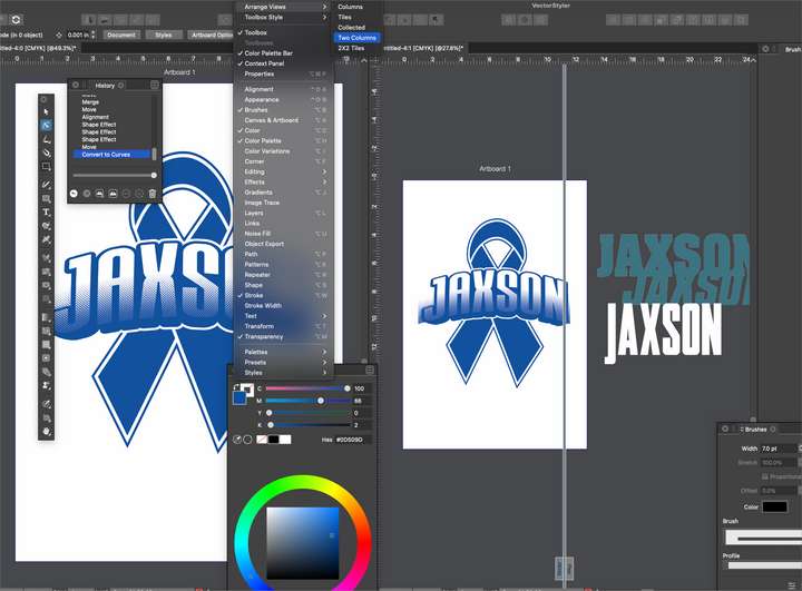

    I knew I had done what you were wanting before in the past - then I remembered it was Panels>Arrange Views>______
    0_1650510360715_e7440bca-9185-4404-a670-3ab169db4c29-BLD 2022-04-20 at 23.05.26.png
  • @Boldline Ahh that's it! Thank you!
    I noticed that "Collected" brings it back to the default lined up tabs. I just thought I would point that out in case someone else was looking for information about arranging the views... 🤓
