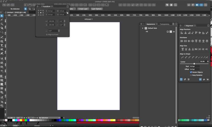

There seems to be a big regression with the panels. When you open a panel, its not easy to move aside from the three stripe button on the left side - it's hard to move or immovable anywhere else on the bar. The panels do not minimize properly and those that do, if you move them, they auto-expand still. I also cannot close out a panel entirely unless I use the smaller tab "x" - the bigger one on the far left side does not work any longer

Still ran into massive issues with the panels - it's like they now do the complete opposite from before the update today. I'm running el capitan if that plays a factor. Is anyone else running into these issues? i also tried doing a total reinstall and that did not help anything.UPDATE: I just updated VS on my Windows 10 laptop to the newest build (54) and ran into the exact same issues there as well.
Panels could only be moved by the three line "grip" section... the large "X" on the left side did not function, panels could be compressed but if you moved it while compressed, it would open automatically when you let go. Some panels disappeared entirely when they were compressed and were moved around on the screen.

@Boldline Partially replicated! If the panel is minimized, and it is moved from the dark title region (not the leaf with the text), then it will expand and goes broke.
It can be fixed by moving the panel from its title.
I added the bug to the backlog.
@vectoradmin I can confirm on the Windows and Mac version of VS, if I drag a collapsed panel by the panel title, it moves fine and stays collapsed as it should.I can confirm also that the broken panels, you can see the sharp corners of a black box near the rounded edges of the panels
I can recover most broken panels - there were a few that just got worse before I tried the drag and drop from the title text to remake the panel.Since then I have been able to recover them all.
