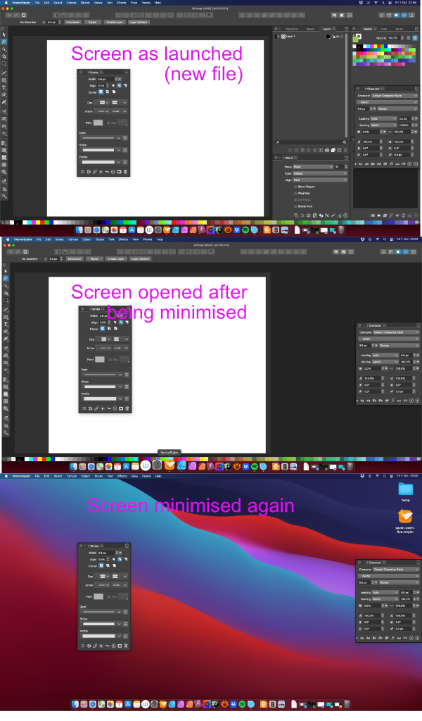

  • Don't know if this is related but I also have an intermittent Mac screen display issue (see screenshots). The panels can be made visible again (in the middle screenshot) by clicking where the should be. The panels (in the third screenshot) can be made to disappear by clicking anywhere on the desktop.
  • @Jono From your screenshots it looks like the panels and the toolbox are not docked — they are floating over the main window.
    If you grab the top panel by the ||| area after the ⨂ close button and drag them all the way to the right side to dock them, this should solve it.
    Or you can start the app while holding Cmd-Option-Shift, which will reset the UI to default, with the toolbox and the panels docked.
    @Jono Panels stay on when the app is in focus (menu bar shown) but the window is minimized. There can be multiple separate windows (with drawings) opened in VS.
    Panels are hidden only of the app is hidden, or goes to background.
  • Thanks guys, I’m new to Macs and still learning! šŸ‘
