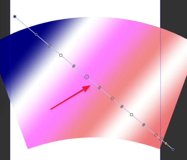

      Could we add a function to the gradient to allow it to be bent and curved like a stroke - through handles and nodes?

        @Boldline Simple bending would basically introduce a vanishing point for the linear gradient, turning it into a conical gradient. It would be a nice option to have, and maybe it's not that difficult to code.
        However… what happens if the user bends the gradient tool into a sine wave shape? You would need two vanishing points. Further bending would need three, etc.
        I guess that quickly becomes too complex, so you're better off served by applying a mesh gradient.
          @Boldline @b77 This one is a bit complicated, but parts of it already exist.
          The most complicated part would be editing the gradient (this would be a new).
          The trick is to use a gradient on stroke on a shape, with a sufficiently large width and the place this inside the other shape to be clipped (in the Layers panel)

              VectorStyler @Subpath
              @Subpath2 Interesting tool. It turns a linear gradient into a mesh gradient directly.
              And the one with the pattern, it is basically a mesh distortion.
              Maybe something similar can be done in VS (longer term), as all the required components already exists.
                Boldline @Subpath
                @Subpath2 Thanks for sharing! that is a cool effect and is along the lines of what I was envisioning. The program you referenced did so with a mesh - in my head I was thinking of the altering the linear line in the gradient as if it were a stroke with nodes and handles... I'm all for whatever works best and is most useful to all. The main idea being a way to alter gradients on the fly.
