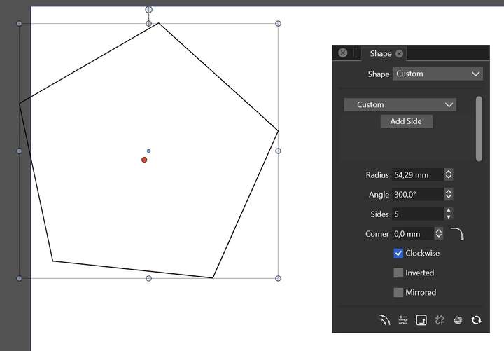

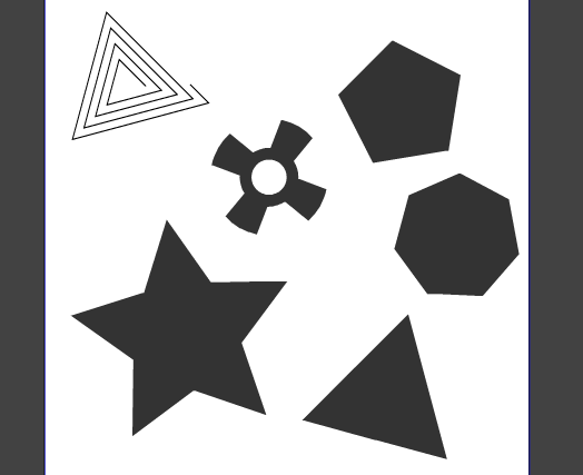

          @vectoradmin All of the shapes in the attached screenshot are drawn using Shift. Where to find the settings responsible for it?
          Edit:
          Ok. I discovered the source of my problems. I'm scaling and drawing objects from top-left corner to bottom-right. Shapes are aligned proprely only from bottom to top.

          Maybe some kind of indicator or axis would make it easier to understand? What do you think? I understand that writing a formula that will be suitable for all combinations without using a box will be difficult?
