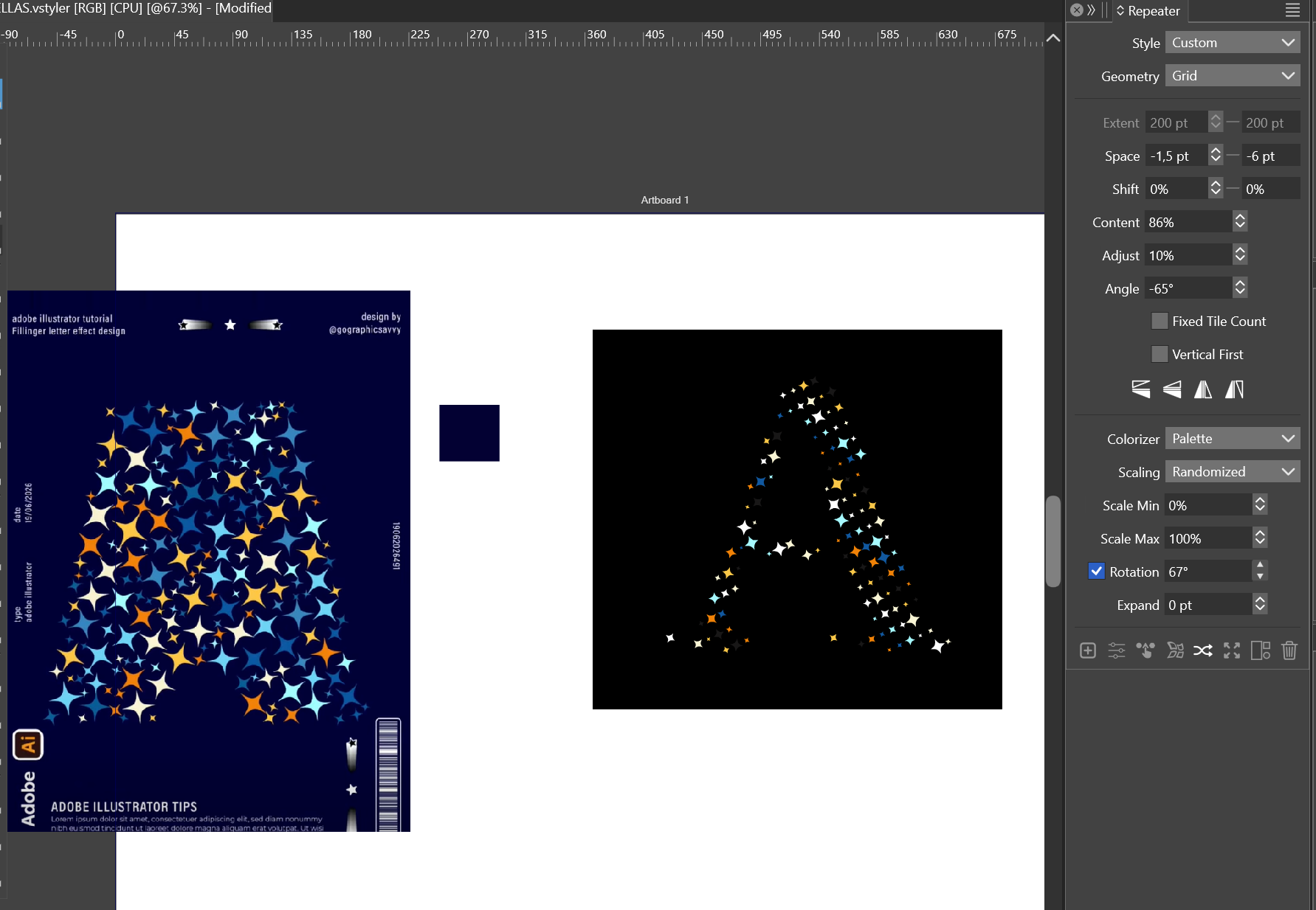

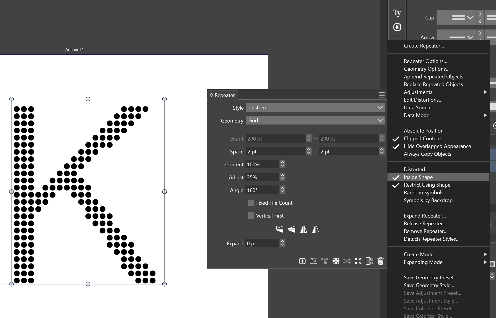

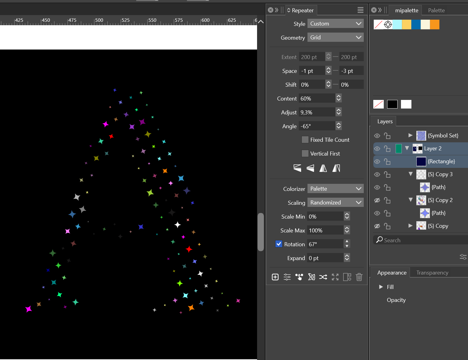

      This finally led me to the solution I had been looking for: using a Repeater with the "Inside Shape" option enabled.
      Unlike the previous approaches, this method distributes the instances according to the boundaries of the shape itself. The spacing can be adjusted independently on the X and Y axes, making it possible to create a regular grid of objects while keeping the workflow fully editable.
      For my use case, this was the closest solution to the original goal: generating a reusable circle-based or symbol-based effect inside arbitrary typography without relying on clipping masks, pattern brushes, or manual Pathfinder cleanup.

        @Clippy-notes Thank you! I’ve learned a lot from other people’s posts here over time, so I’m glad if something I shared was useful in return.
        I like the way you documented the full process here and not just the final answer. The key distinction is that this was never just a clipped-pattern issue. It was a shape-aware distribution issue, and Repeaters with Inside Shape seems like the best solution.
        I also appreciate that you showed the failed approaches. That makes the post more useful, because it explains why pattern fills, clipping masks, scatter brushes, and halftones only get part of the way there.
        Nice job with this. It will probably save other users a lot of trial and error who run into the same problem later.

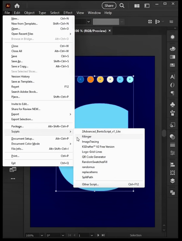

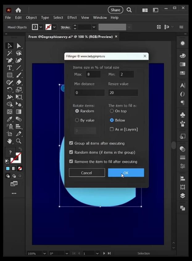

        After I had read through your informative post, I came across this related solution in a facebook reel.
        This is the same kind of result I was looking for in my original post you had referenced. (It would be nice to allow for fixed size and variable results). I'm looking forward to when scripting is added to VS because that would open up possibilities such as this example without the developer needing to add all options himself.

        • Clippy notesC Offline
          Clippy notes @Boldline

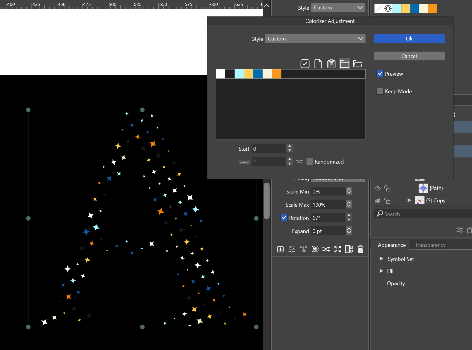

          @Boldline I also tried looking into Fillinger script, but I’m not sure if there’s any way to add scripts to VectorStyler.
          Regarding Fillinger, the repeater already includes all those features in the advanced settings, and in the three-line mode you can add a randomizer method. In the documentation, I believe it said you need to group the objects first and then apply the repeater.
          I might try to replicate it; it looks cool.

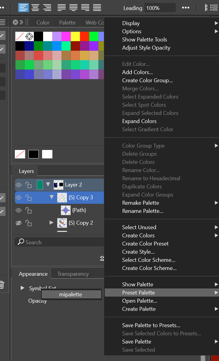

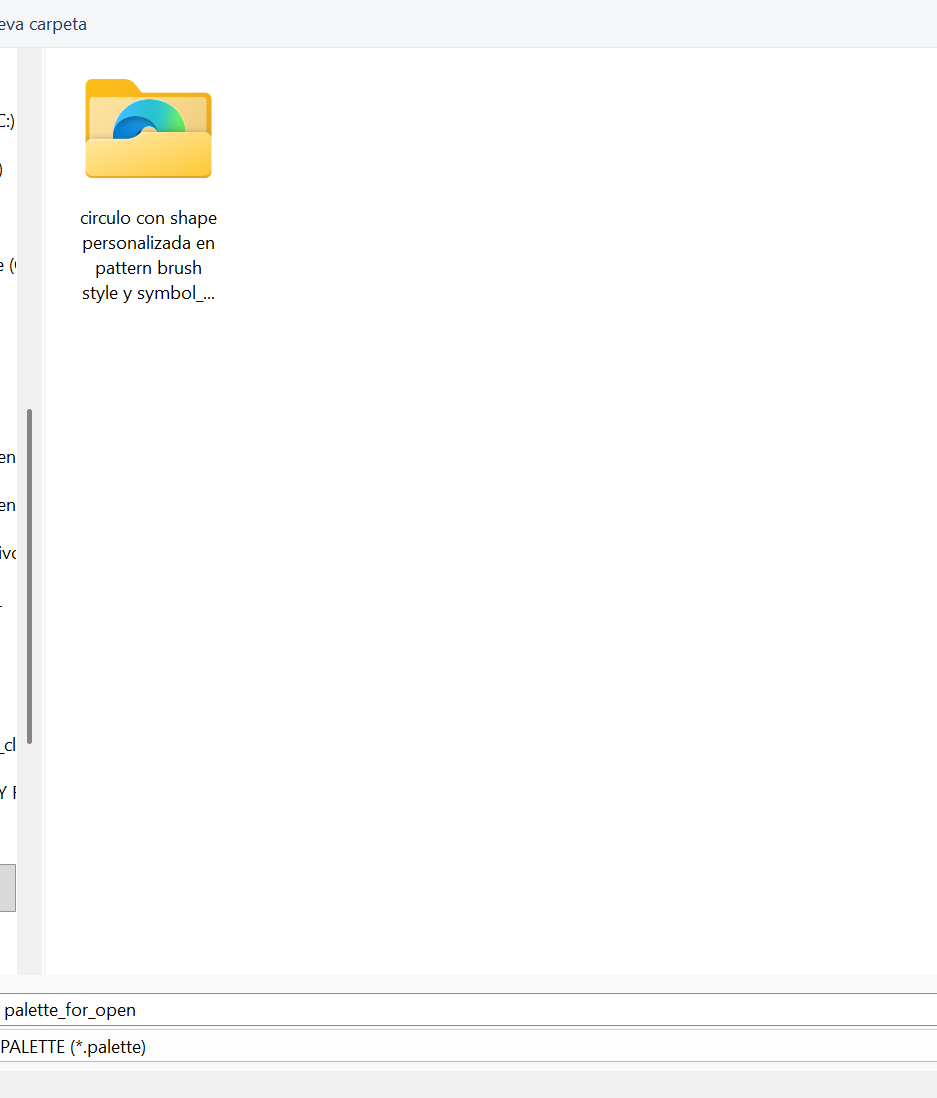

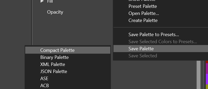

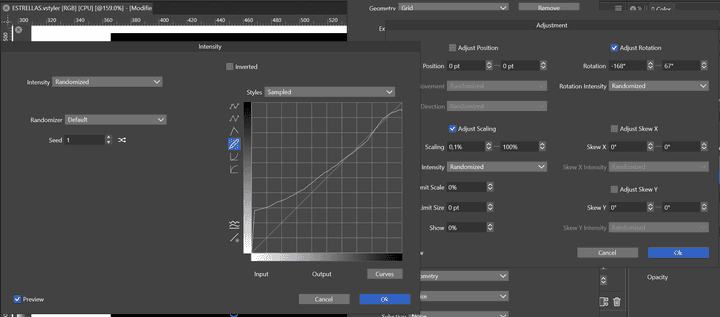

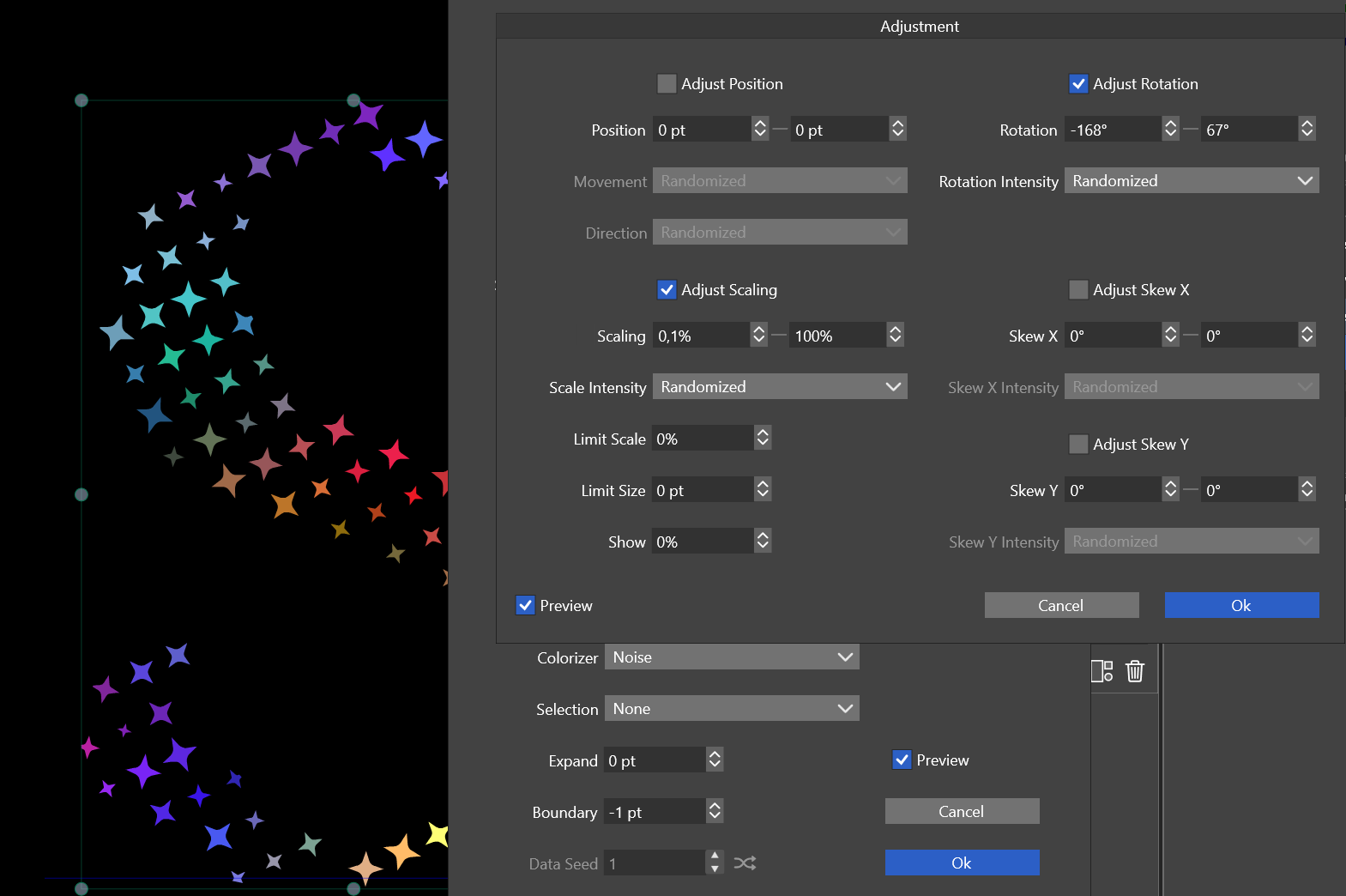

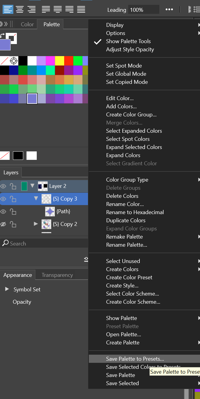

            @Boldline
            Ajustment - geometry - edit
            color palette:
            29e4ff59-f690-47d5-9426-953d3d854546-image.png ![0538d1aa-da94-4d1d-bd1b-30863176e934-image.png]
            (/forum/assets/uploads/files/1781986688493-0538d1aa-da94-4d1d-bd1b-30863176e934-image.png)
            Done
            -- randomizer rotation
            -- intensity adjustement scale
            -- custom palette

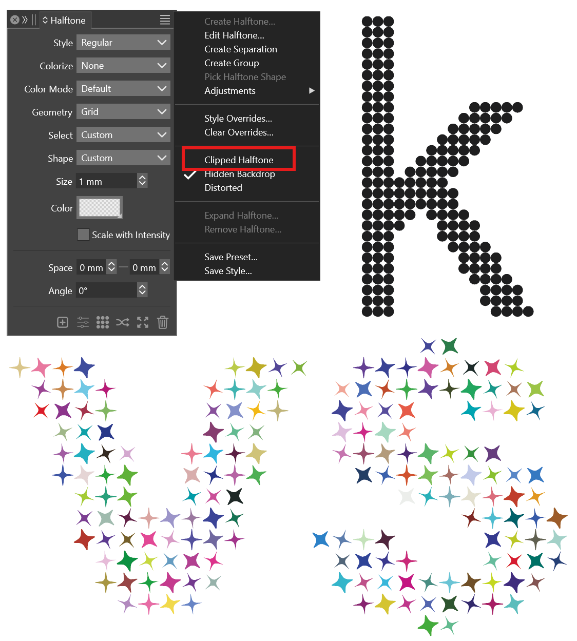

            • L Online
              Li Xiao @Clippy notes
              @Clippy-notes
              Thank you for sharing

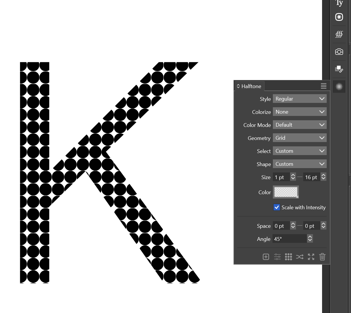

              Then I thought about using a halftone-based approach.
              At first, it seemed like a promising direction, since halftones are specifically designed to generate regular patterns of dots within a shape.
              Unfortunately, I ran into the same limitation.
              Halftone can also generate text filled with complete symbols, just make sure 'Clipped Halftone' is unchecked
              https://drive.google.com/file/d/1RI8qHCvHnUjRZy8AEp2BxQJVW2vOZxZc/view?usp=drive_link
              Halftone complete symbols.vstyler

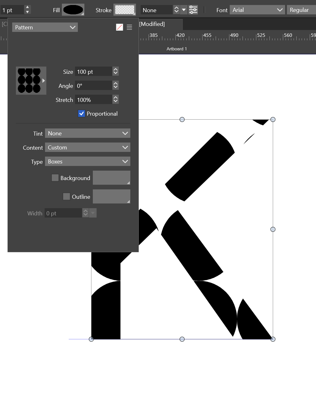

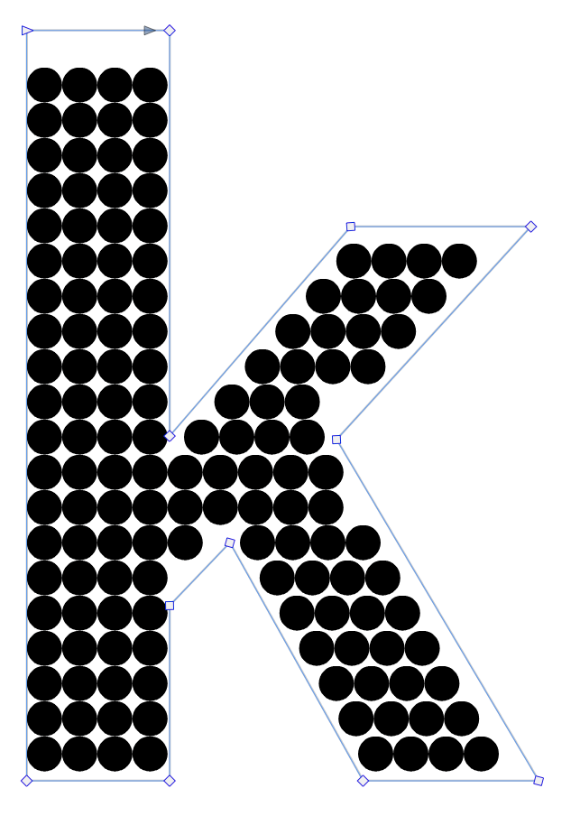

              • R Offline
                Raven
                A very simple option is to use text flow in a shape.
                The example below is a drawn circle (but could be anything) pasted repeatedly into a "k" that was converted to a path and used as a text frame.
                Each circle is effectively a single character, so spacing can be adjusted with kerning and leading.
                Each horizontal line of circles can align to the left or right edge(s) of the available space(s).
                Have done this before in InDesign or FreeHand.
                I'm not sure what's causing the excess space at the top.
                F 1 Reply Last reply Reply Quote 0

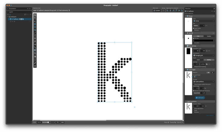

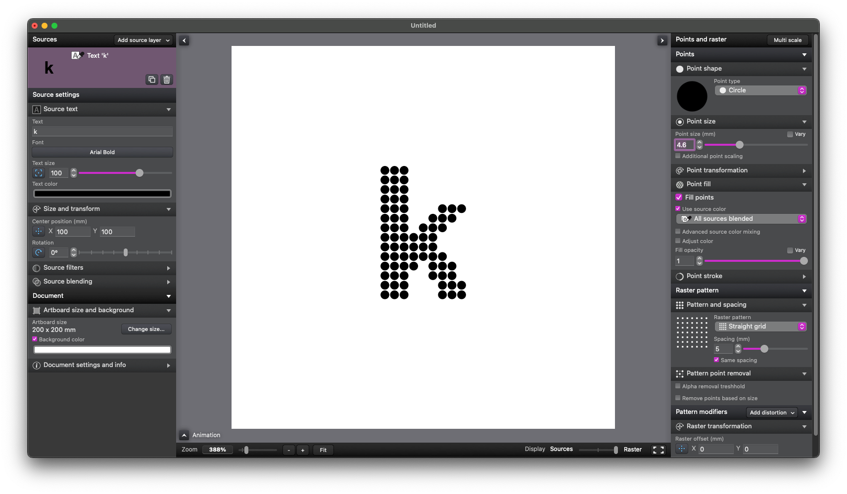

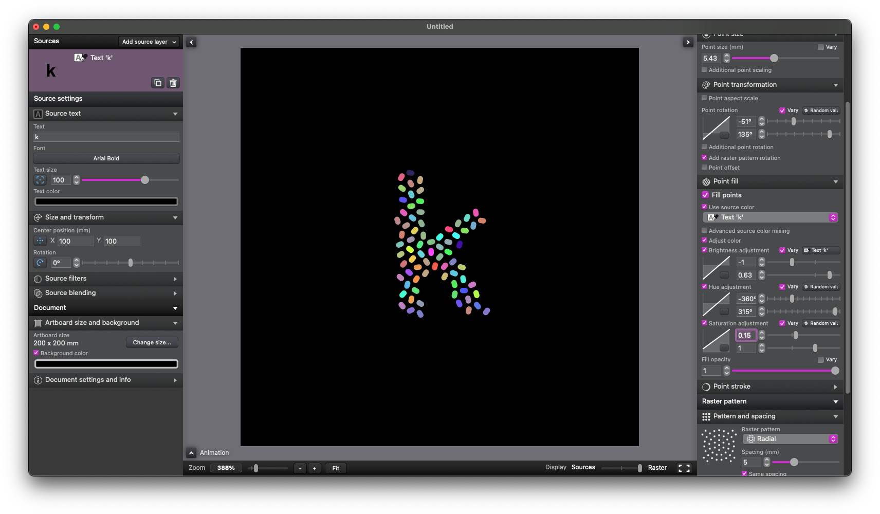

                  Vectoraster (lostminds.com) can easily do this sort of thing, though it is Mac-only and you appear to be using Windows.
                  It can animate the renderings too for those so inclined.
                  A specialized tool, but a useful one sometimes.
                  EDIT: Paragraphic (also from lostminds.com) can also do this and is cross-platform. Slightly less straightforward and no built-in animation capabilities that I have ever found. Not exactly the same as Vectoraster but good enough for things like this:
