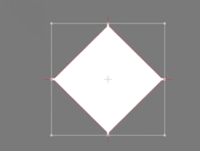

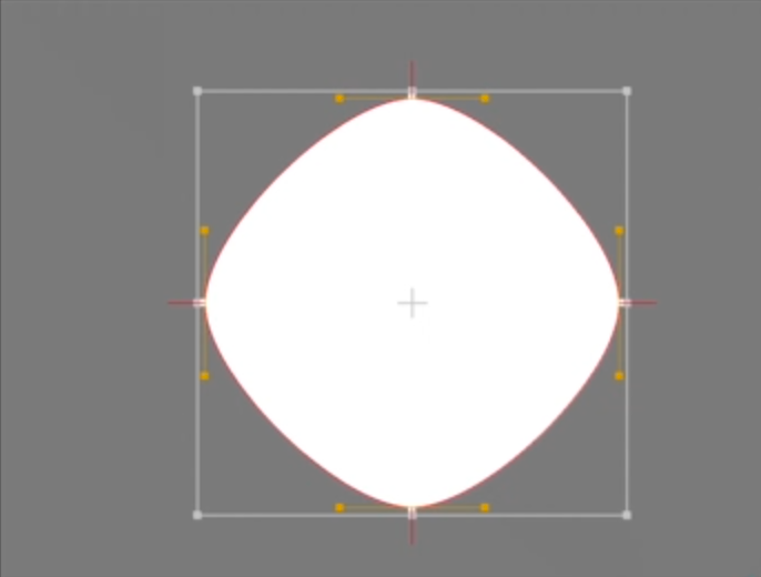

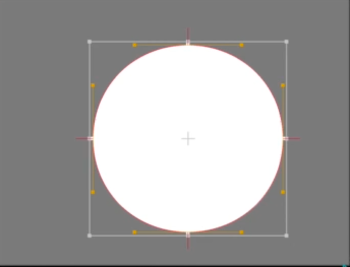

      Hello
      there is a keyboard shortcut to increase or decrease the length of the handles on vectorstyler?!
      THINKTANK 2026-05-09 à 21.48.52.png THINKTANK 2026-05-09 à 21.49.09.png THINKTANK 2026-05-09 à 21.49.23.png
      Cordialement Votre
      BoldlineB VectorStylerV 2 Replies Last reply Reply Quote 0
        Boldline @ZATOPEK
        @ZATOPEK select the nodes you want changed with the node tool and then press the number 1 on the keyboard
        • ZATOPEKZ Offline
          ZATOPEK
          I'm doing the test with my MacBook Pro but without success ?!?!
          Cordialement Votre
            VectorStyler @ZATOPEK
            @ZATOPEK For making the nodes smooth (or symmetric) there is (shown in the tooltip of the action from the context panel).
            But for just brining out the handles and moving outwards, no shortcut (and no such feature)
