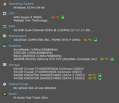

                        @VectorStyler No, is windows 10. Here is my specs
                        Memory 48gb ddr4
                        NVMe CT100p 1TB
