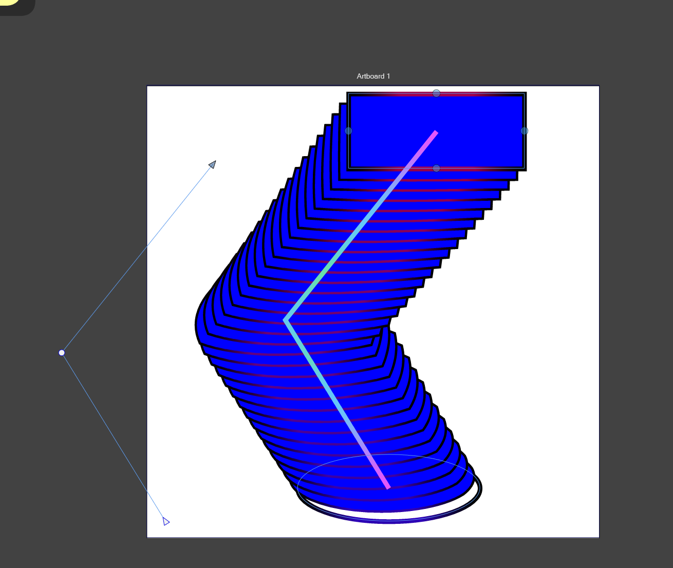

      Or maybe the curren Deactivate Linked Path option is bugged.
      One click
      (is a linked path active)
      Linked_path_error.vstyler
      Normally, if it's linked, it should be locked, but the line shifts a few steps, and when you press it, since it's not locked, this happens.
      S VectorStylerV 2 Replies Last reply Reply Quote 2

          VectorStyler @Clippy notes
          @Clippy-notes I will try to fix this
