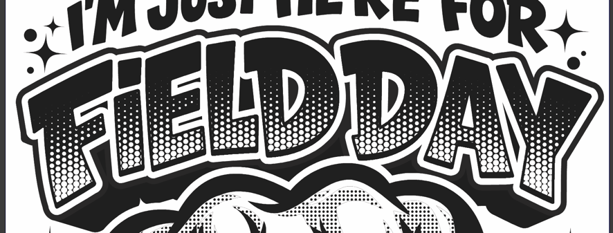

      What would be the best way to curve a gradient. For example, in this situation, I'd want the gradient to curve with the text
      I know I could use the warp tool, but that does not affect the gradient, just the shape the gradient is within.

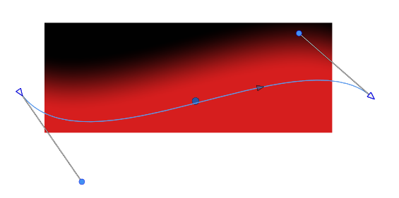

        @Boldline You can curve it separately (will not follow the text, but can be made similar manually).
        Use the gradient shape tool for this:

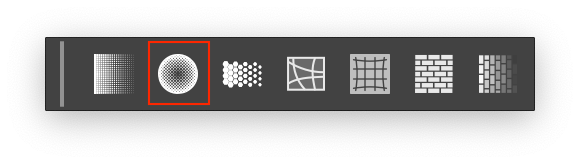

            as vectorstyler mentioned the Gradient Shape Tool
            i made a video here

              Thank you all for taking the time to share how to make this happen.
              Always learning new things in VS!
