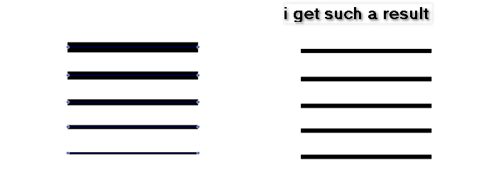

      Here is what i get

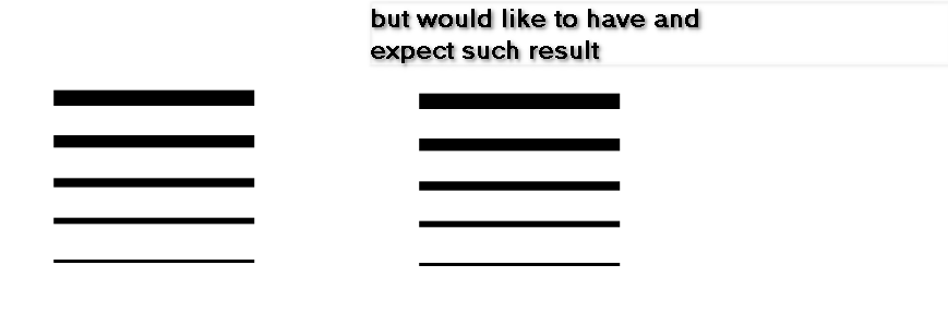

      Here what i like to have and expected

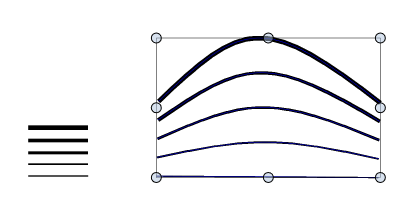

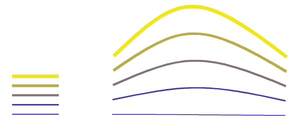

            And of course it works even with colors
