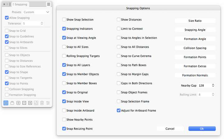

Snap to Shape and Snap to Points are both On. Show Indicators is On.

While I'm here, why does VS snap to objects on hidden layers? Shouldn't they be automatically excluded?
@Raven There is no settings for this. All selected nodes will snap by design.
It does so by design. Should there be an option for this, or just no snapping for these?

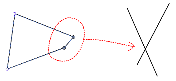

The particular document I was working on can't be released, but I've attached a trivial demo doc with just a couple of simple shapes.
0_1768433136421_Snapping when dragging multiple points.vstylerSay for example I want to snap the right node/s of the triangle to the intersection of the two straight lines.
Snapping when dragging just one node works as expected.
But, if I select more than one of the nodes on the triangle, manually or with a marquee, then drag one to the target - it doesn't snap. It's desired that the dragged node be considered as the key for snapping - the other dragged nodes should just move in sync.

Yes, I see no purpose in snapping to them. I use layers a lot for interim/alternative versions of a design: duplicating a layer for safekeeping before continuing work. In later stages I can show/hide the old/new design layers for comparison of progress, choosing the better one. I also duplicate layers before carrying out a destructive operation. Snapping to the "old" invisible layer is unwanted.
The only workaround I can see is to manually open the Layer options for each of the currently invisible layers and in the Geometry tab >> Options button >> deselect all the snapping options. Awkward when frequently changing which layers I am working with.
Given that this doesn't seem to have been a topic before I assume that others don't have an issue and it would need to be an option. Perhaps the current "All Layers" setting for snapping can be multiple choice with an alternative of "All Visible Layers".
Affinity has an "Only snap to visible objects" setting in it's snapping panel (and dragging multiple nodes does work as expected).

Could the issue of snapping an object to a specific point when dragging be fixed as well? This function is used quite frequently.It should only snap the selected point, while the other points of the object itself should not have the snapping function enabled.
@monsterfox said in Snapping when dragging multiple nodes:
The next build will solve this issue in a bit different way: all dragged points will snap.
I will release this first.
