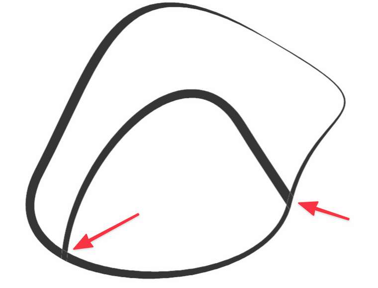

        @Boldline I made a similar drawing of the claw with the Pencil tool and after expanding the strokes, Divide splits the objects correctly here. Could be something different with some of the paths used for Divide in your screen recording? If that part of the drawing was made available for the developer to test, maybe it would help figure what causes the Divide glitch.
        Btw, when tracing manually over a sketch, you could try the Path Sketch tool. It will automatically join intersecting strokes by using only the longer part of a stroke for the new object: https://vectorstyler.com/documentation/shapes/pathsketch/
          @Boldline The process is complicated a but when using Brushes. The Expand Stroke will result in an object with the artistic brush content and a bend effect on it. This is why a convert to curve is needed to get to the filled shapes.
          For the type of drawing in the example, the Pen tool will do, with the Pressure mode (in the context panel) set to Selected to use the current width profile selected in the Stroke panel.
          The pen tool will result in regular strokes (not artistic brush paints), and expanding these results in filled shapes.
