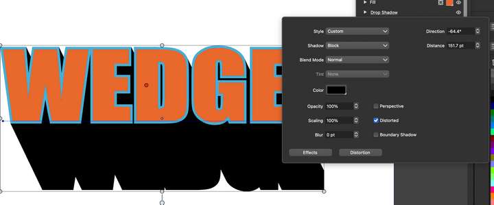

      What is the best way to expand out the drop shadow if we are done modifying and want to make it a destructive final and no longer worry about line editing? I know that could get a bit tricky with a blur and/or lowered opacity. Would that convert to a png or bitmap? If the drop shadow was a pure solid color like in the sample image I attached, that can remian a true vector? Could this be done with an option like what is already available with the blend tool - a button you click to expand it and also with the merge boolean?
      0_1764132728231_f0dc1764-8fc0-4751-9aa3-45d3a1ce0c9f-CleanShot 2025-11-25 at 23.49.15.png

          @Boldline said in Drop Shadow Improvements:
          you can expand appearance and solid shadow expands as a vector shape
