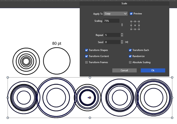

        As I already mentioned, I see no reason for this as a user.
        I would expect copies below 75% or at most exactly 75%.
        Anything else doesn't make sense to me and isnt useful.
        In my case, the circle should maintain a fixed size and not increase
        in size. But inside it, it could contain several smaller circles of
        random size.

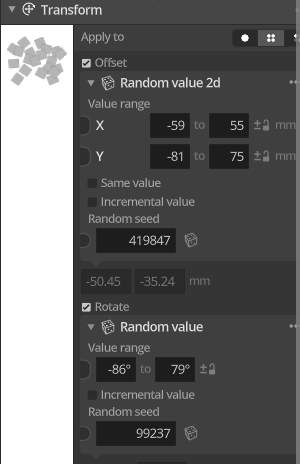

            @VectorStyler I wanted to raise a feature request on this and the randomization in transform panel.
            I also have frequent need for asymetric randomization, meaning that if I select 75% scaling, I would want the objects to be scaled randomly between 75% and 100%. If I choose 200%, I expect objects to grow from 100% to 200%.
            Same goes for x, y offset where the randomization gives same results in positive or negative offset. That's not always desirable when you want to shift copies to one side randomly to create a trail
            There can also be a need for scaling symetrically around 100% (the +/- scaling), which is another use case.
            With only one slider, it is not easy to accomodate both needs. Maybe you need 2 sliders (min, max), or better, a checkbox to choose the mode to use
            It would be for all transform parameters, not just scale.
            Also, a reset button for the transform panel would be welcome as there are a lot of parameters

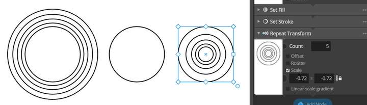

              As an example Paragraphic always generate smaller copies when
              scaling down and larger copies when scaling up.
              Here a picture

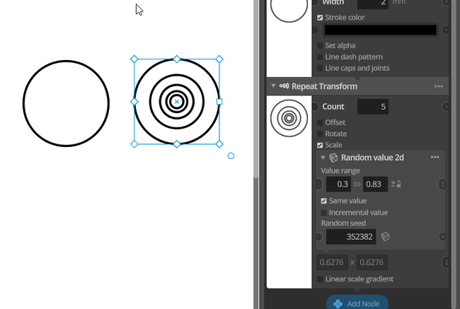

                  Paragraphic's repeat transform is not scaling randomly. When you specify that scale a value less than 1 will give you smaller circles each time, while a value greater than 1 will give you larger ones each time.
                  You need to explicitly tell Paragraphic to use randomness, and when you do, it allows you to specify a seed and a min/max range within which to randomly modify the values it is being applied to:

                    Subpath
                    @fde101
                    The point was simply to demonstrate the principle of paragraphic scaling, and in my example, I only mentioned how paragraphic scaling works, not that it was randomly scaled.
                    You can, of course, also generate copies randomly by using the "Randomize 2D" input node. Here too, the size of the original object will not be exceeded as long as you keep the Value Range below or at a maximum of 1.
                    If you want to like to have random values ​​within a larger range,
                    then you can also enter values ​​greater than 1.
