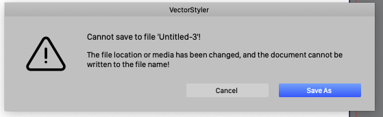

      After updating to 1.2.076, I can no longer save files.
      The following alert appears. (License 0)
      The document content is simple, such as a single rectangle.
      I can save files without any problems with 1.2.034 on the same machine.
      I have performed maintenance on my Mac using TechTools, etc.
      LIc. 0 OS10.15.8
      LIc. 1 OS15.7.4
        VectorStyler @861475_VctSt
        @861475_VctSt Most likely something broke with the update.
        Remove VectorStyler completely also the settings folder (Help -> Reveal Workspace)
        Download and install again.
        What happens immediately after selecting the Save command for a new file? Did it show the Save panel?
        And what folder was selected?

          861475_VctSt @VectorStyler
          Thanks.
          As you pointed out, there seemed to be a problem during the update. I deleted all VS-related data, did a clean install, and the problem was solved.

            @861475_VctSt said in Can't save:
            It should be enough to backup and restore the /Users/hara/Library/Application Support/NumericPath/VectorStyler1.2/vector/data/resources folder (important: "resources", not "presets").
            The problem is that if there was any settings / workspace option causing this issue, then it might persist.
            Next time if this issue occurs, please send me the content of the "resources" folder
