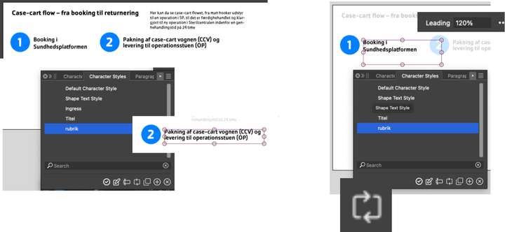

      I want to update (syncronize) defined character style but nothing happens to other fonts with the same style.
      Text 1 is leading 120% and Text 2 is 100%, but are the same style “Rubrik”. I want the “Rubrik” updated to Text 1, but no cigar. Do I miss something out?
      0_1752137539135_sterilcentral-instrument-og-vareflow-120625.vstyler

        @Raaskot Is the leading set in the Paragraph Style or Character Style?

          Ah, perhaps that's the issue. How does VS apply changes (for proceeding inclusion) to styles from the top bar? Is this a bug?

            @Raaskot Those values (red marker) are part of the Paragraph Styles.
