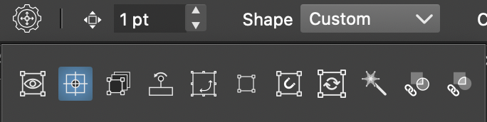

@jpsimmons When the transform tool is active (first icon in the toolbox), the context panel will have this button.
This opens the transform options:
The second icon can enable or disable the center offset.
The tooltips say to enable or disable the transform pivot point editing, which sounds like the right thing. I click on it and nothing happens, but it is highlighted in blue. How do I set the point of rotation and how do I rotate about it?
@jpsimmons Once it is enabled, when an object is selected a red dot appears at the center. This can be dragged to set the center.
@VectorStyler That works. Well. Can I set this to be default behavior? Like in "settings"?
@jpsimmons That is the settings. Once turned on, it should stay on even after restart.
@VectorStyler It does. And the pivot point snaps to gridlines if you set it to. Nice!
