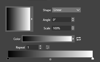

          This is the Gradient i use in both Movement and Direction.

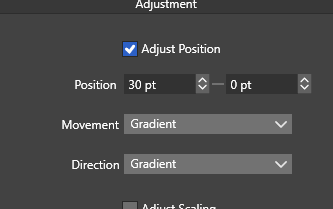

          The Value i used

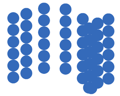

          The Result

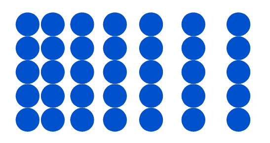

          I expected something in this direction

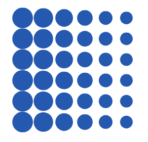

              Here a Video with adjust scale
