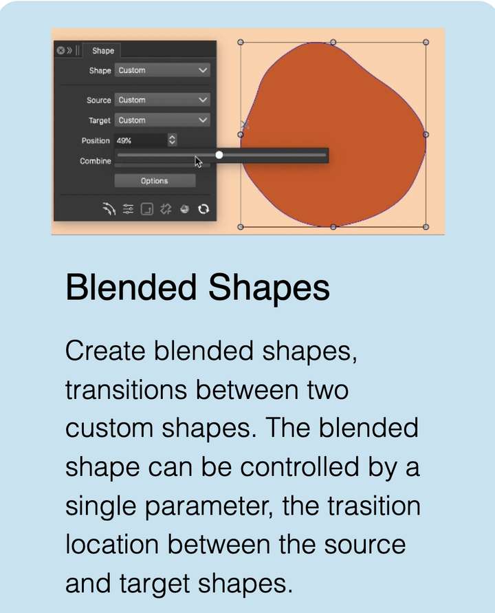

      I'm trying to replicate the example on Vector Styler home page but can't find how it should work. Any advice on this ?

        @EricP Follow these steps:
        • select 2 shapes to create a new blended shape from.
        • in the Shape panel: click on the Shape dropdown and select "Blended Shape Preset" (there are other also, more on these later).
        • give a name to the shape and confirm.
        • this creates a new shape preset that is a "blended shape".
        • now draw a new shape (anything).
        • and with the new shape selected, choose the previously saved "blended" shape in the Shape drop down of the Shape panel.
        • now the Position slider should be able to adjust the blending position.
        • the "Blended Shape Style" creates a shape style (remember styles vs presets differences)
        • the "Blended Shape Style" also creates a shape style, but it will link to the original shapes.
