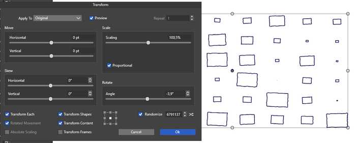

Scaling with "for each" in Transform panel works way too hefty.
  • Scaling objects with " For Each " in the Transform panel works way
    too hefty in my eyes. It would be nice if a user could specify
    a minimum and maximum scaling.
    The size difference is too much for 100,5%.
    But could also be a bug, dont know.
    Here a approach of mine, scaling is 100,5%
  • administrators
    @Subpath I opened a bug on this and will try to find a solution.
  • yes I observed the same and found it excessive too. I think the scaling randomization picks a random value between 0 and 100.5%, which yields to extreme variation.
    Offset and rotation being in absolute values - not percent, the effect is easier to adjust precisely
    With only one cursor for scaling, maybe the variation in that case should be +/- 0.5% (99.5% to 100.5%) to remain more subtle.
