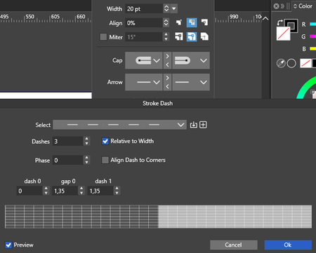

After watching a video about a dash pattern trick for Illustrator.
I experienced a bit with the dash settings in VS and found
these possibilities.
Dash patterns, you may not know.
The dash pattern settingsHere the settings, the trick work by using different Cap shapes.
Add to this that you can create custom Cap shapes in VS
and you may see the possibilities.
dash pattern 1 settings

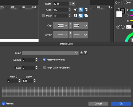

dash pattern 2 settings

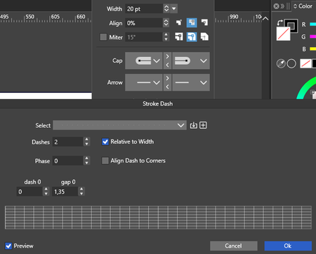

dash pattern 3 settings

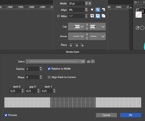

dash pattern 4 settingssettings
dash pattern 5 settings
Here the Profil i use

@B-Vs-V said in Dash patterns, you may not know:
what I don't understand is the lack of visualisation of all the lines/dashes and the gaps
In that image there is a 0 dash, which results in a dot. What visualization issues are there?
The Dashes themselves are pretty well visualized, I would say.
The Pattern which results from using Cap shapes need a
bit experimentation, i think. But with Preview on, it looks easy
to me to spot the usable one by playing with the dashes settings.Found the Pattern above by just playing around a bit and tried
different Caps

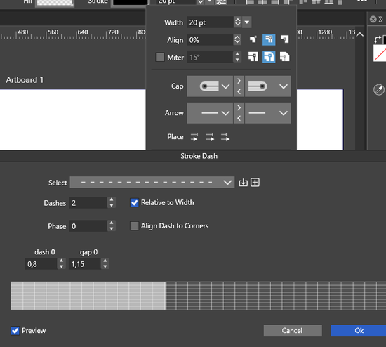

Found two more
.Dash pattern settings 1
Dash pattern settings 2
