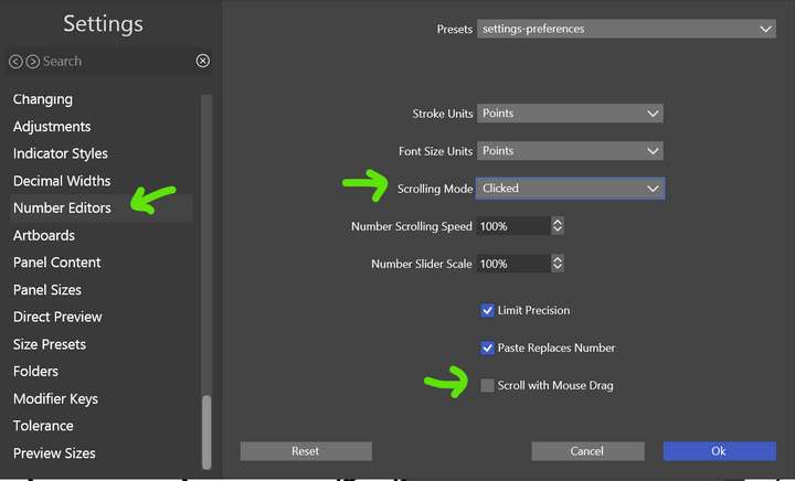

      Can we cancel somewhere the possibility of changing values ​​everywhere with the mouse wheel? With an Apple mouse, it's really too much a trap.

        @fdarnel Yes, it's under Settings:
        Scrolling Mode can be changed to "None". I also recommend to turn off Scroll with Mouse Drag.

          Thanks!!! It seems you also have to restart VS.
