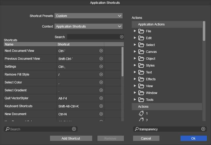

Could you differentiate the shortcuts between the main keyboard and the numeric keypad? I would like to use the number keys on the main keyboard to set tools and the numeric keypad to set transparency. This would make operations more convenient. I hope this feature can be added.

Also: what is shown in the shortcut key editor when you press a key combination containing a numeric keypad key?
@VectorStyler Mine is Windows 11, and the keys are not responding at all.
@VectorStyler Discovering that transparency is a system-default shortcut with no configurable source, could it be added?

No clear what is needed here. Should the transparency key presses (number keys) be customizable?
It can be turned off with the Settings -> Changing -> Opacity Editing Keys checkbox.
@VectorStyler What I mean is that the default shortcut keys for setting transparency in the software are the number keys on the main keyboard. I want to set these shortcut keys to the number keys on the numeric keypad.

At least here, this seems to be working with the numeric keys also.
If I need to add a shortcut for opacity, where should I look in the menu? Perhaps I haven't found it yet.
@VectorStyler I think I know where the issue lies. The shortcuts on the main keyboard and the numeric keypad are synchronized. By default, both can be set to adjust opacity. Now that I've set the number 6 on the main keyboard to the pen tool, the 6 on the numeric keypad has also changed to the pen tool. The shortcuts for the main and numeric keypads are not separated.

For opacity, the shortcuts are not customizable in this way. It is either disabled or enabled.
@monsterfox said in Distinguish keyboards:
I will try to find a solution for this.
