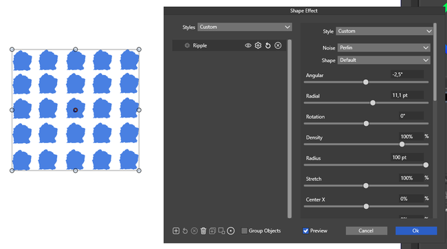

A kind of "for each" for Shape Effects
If you apply a shape effect to a series of objects, all objects will
get the same shape effect. See image.It would be nice if the shape effect had an option that worked like
"for each" when transforming. So that each object gets the shape effect,
but each one slightly differently. If that's possible.
@Subpath The only way to do this now is with the repeater, number variables and randomizing the variables with the repeater.
I thought this kind of "for each" option for shape effects
would be a nice and useful addition in the future.Would it be possible for you to describe the steps required to
use that repeater option? That would be very helpful as I have
not used the number variables in the repeater yet and I don't
know how that would affect a shape effect.
