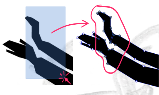

Node tool, drag select - short key: How do I select and activate every nodes in same shape?
 VS’ Node tool: Drag-LM selects nodes and make them active. Same thing with Adobe Ill but here you select and activate every nodes in same shape by pressing option. How does this works in VS?
 To select all nodes of a Shape
 use the Note Tool do a left click on
 the shape and press Ctrl+A on Windowsinstead of left click, hovering over a shape
 and press Ctrl+A works also
 @Subpath
 So cool, thanks!
 indeed  but I have to correct myself a little
 select at least one node of that shape
 and then press Ctrl+A
 this will work better if you have many shapes
 @Subpath
 Thanks. Noticed the same when I tried it out, very useful. Like VS procedure better than in AI

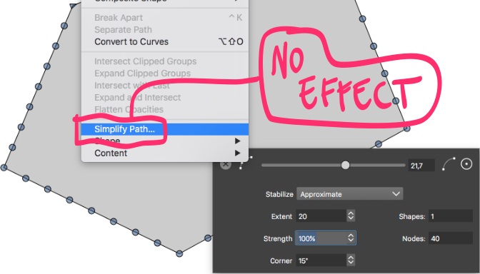

 Cool tip with adding nodes. Off topic: How do you reduce nodes again?The Simplify Path has no effect.
 good question of course undo the only other ways i found was via History Panel
 ( Menu > Panels > Edit > History )or via a Lasso selection
 @Subpath
 Guess I'll report a bug ...
 I was thinking about using the " - " (Minus) Key
 for delete nodes was inserted via plus key ?
 @Subpath
 Would make sense with "-" --> node reduction, but it doesn't seems work.And odd: It appears the reduce node function actually works yet on and off only. As if you must deselect and reselect the shape everytime. Strange ...
