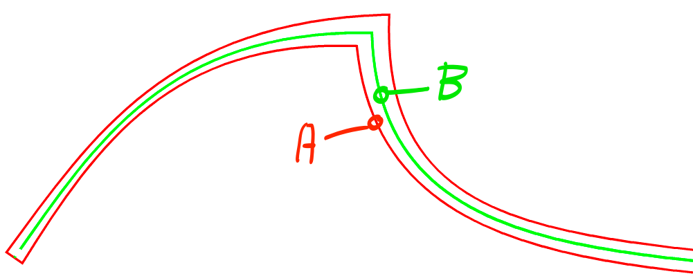

 Is it possible to have VS calculating a centerline (B) or path of closed shape (A)?
 @Raaskot said in Calculating a centerline in VS?: Is it possible to have VS calculating a centerline (B) or path of closed shape (A)? No such feature.
 Sad, but thanks.
 @Raaskot Just realized that this could be done with a blend.
 Delete the segment at the endings, break apart into 2 curves, reverse one of them to align and the create a 1-step blend.

 I think what he needs is the function I mentioned before. This function is still very useful and I hope it can be added.
 Agree, but if the object is closed, meaning hollow (like ie. o's or b's), and more complex, like a freehand drawing, it's too complicated to perform this.
